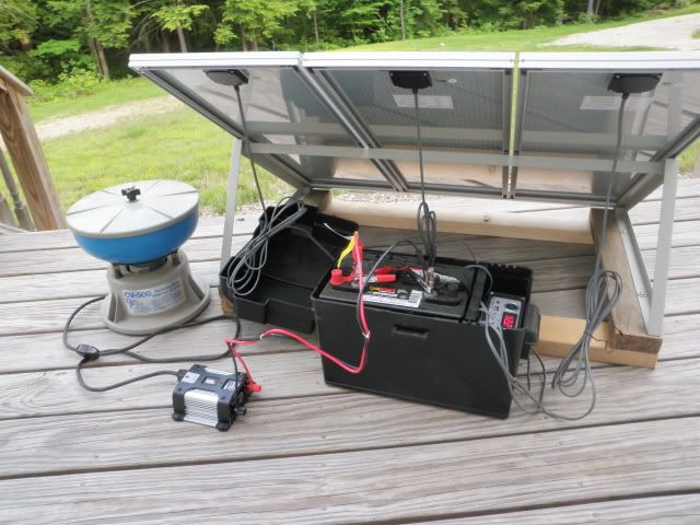

Pathman ,
I just picked up that kit also.  I was about to start a thread and ask some questions myself - thanks!  (I hope you don't mind me jumping on)  :-[
I've been experimenting with what this kit can do for me.
It ran my Dillon case cleaner (1.6 amps) for three hours before the inverter's low voltage cut-off kicked in.  That was plenty of time to clean load of 5.56mm brass.
I've also run a laptop and my dremel tool on it for short periods.  Recently, I picked up a 1000 watt inverter (still need to wire it up) to run some small power tools.
For those of you who have more experience with solar than I do (I'm a noob), please comment on the following:
*My assumptions:
- If I add another battery in parallel, I can increase the run time?
- If I add more panels, the batteries will charge faster?
Questions:
I'm having difficulty finding any information about how many of these solar panels I can connect to this single charge controller.  Is there a rule of thumb for this?
When connecting batteries, is it best to use large wires?  For example, would it be harmful to salvage an old set of jumper cables and cut them to fit between batteries?
How does this effect the wire size between the batteries and the charge controller?
How does this effect the size of the wires between the batteries and the inverter?
In my picture above, the panels are oriented directly south. Mid afternoon, they become covered by shade from trees (which are not on my property).  Would it be beneficial to adjust the angle more toward the east in order to take advantage of more sun during the morning / early afternoon?
Thanks, Andy

Pathman ,
*My assumptions:
Questions:
Thanks, Andy
Questions:
The main limitation for charge controllers is current. This harbor freight system puts out a max of 3 amps... so for a 10 amp charge controller, you could safely run 3 panels of the same type (9x 15 watt panels total)
Given that you have a 1000W inverter (probably sized for 2000W starting surge) I would use a gauge of wiring capable of handling 170A of current.
I think jumper cables would be an excellent gauge of cables to use to connect the batteries together in parallel with your 1000W inverter. Jumper cables are designed to handle this level of current.
As a side note, I would suggest using a fuse between your battery pack and your inverter. Also use a fuse between the charge controller and the battery pack. As you add more batteries to your battery pack, the amount of energy stored can get dangerous if you short together the output.
it all depends on how much current is coming from the charge controller.
for a 20 amp charge controller, I would use 12 gauge wiring. If your using something smaller than a 20 amp controller, I would still use 12 gauge wiring because it's relatively inexpensive.
wire sizing should be based on the max current draw from the inverter (estimated to be 170A) and the length of wire between the inverter and the battery. I would minimize the length to as short as possible. If you have a certain distance between them of significant length (more than a few feet). You will have to increase the gauge to account for the potential voltage drop. I can give more details on this if applicable
It would be most beneficial to have the panels face the sun through the duration of the day. If you do move the panels to the east in the morning and move them again to the west in the evening... you will send more energy to the batteries.
Hope this helps you out!
Let me know if you have any further questions.
Offline Andy in NH
  • Posts: 234
  • Ex injuria jus non oritur
Re: Harbor Freight 45 Watt Solar Panel Kit
« Reply #14 on: August 23, 2010, 05:13:12 PM »
It sure did!  Thanks!
I'm sure I'll have more questions in the future.

I have used that same solar kit for about 2 years and I use others as well.... but I want to point out something nobody else seemed to say about them.
They are Amorphous... meaning they will generate on a cloudy day while the poly and mono cells generate less on cloudy, but more on sunny days. Also, Amorphous cells will de-generate faster than mono and poly cells. You should get 10 years of moderate power generating, but they will produce less power and less power as the years go. Mono cells can go 25 years, but then will start falling downhill.
I have lots of trees and decided to use all types of cells, and basically just charge a pair of golfcart batteries, which power 12v lights and other 12v gadgets, occasionally using an inverter when the power goes off. My advice to you is to put your money into your battery bank rather than solar cells, but use solar to 'top off' your batteries. I also have a motorcycle battery charger on a timer for an hour each day to make sure my battery bank is full. That way even a small solar panel collection can work for you. Even that 45 watt kit will work as long as your battery bank has enough energy for your needs.
